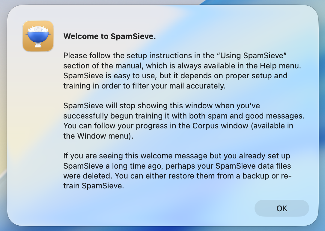

Before you can use SpamSieve, you must give it some examples of messages you consider to be spam, and ones which you do not. You do this by selecting some messages and then telling SpamSieve whether they are spam or good. SpamSieve collects information from the messages it’s trained with into its corpus, which it uses to predict whether subsequent messages are spam.
For the details of how to train SpamSieve, find the section below that corresponds to your e-mail program. For now, what’s important is that you will train SpamSieve with both good messages and spam messages. Don’t worry; it learns quickly!
First, you’ll train SpamSieve with a batch of messages to get it started recognizing your mail. The Corpus section at the bottom of the Statistics window shows how many good and spam messages SpamSieve has been trained with, and what percentage of them are spam. After the initial training, SpamSieve will automatically train itself, and you’ll only need to train it to correct mistakes.
