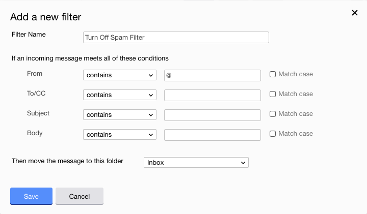

Yahoo Mail
Click on the gear menu, then Mail Options, then Filters. Create a filter that matches @ in the sender and delivers the messages to Inbox:
images/yahoo-mail-spam-filter.png
