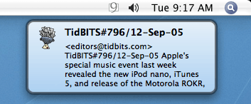

Good Messages (in Address Book)
This posts one notification for each good message that arrives (where the sender is in your address book), showing the message’s subject, the first few lines of its body, and (if possible) a picture of the sender.
