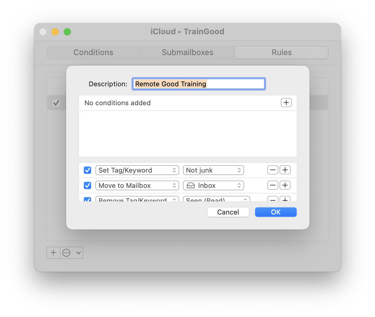

  3. For each TrainGood mailbox, select the mailbox:
    1. Go to the Mailbox menu, and choose Edit Mailbox….
    2. Click on the Rules tab of the TrainGood window.
    3. Click the + button at the bottom of the window.
    4. In the Description, enter Remote Good Training.
    5. At the bottom of the window, create three actions:
      • Set Tag/Keyword: Not junk
      • Move to Mailbox: Inbox
      • Remove Tag/Keyword: Seen (Read)
    mailmate remote train good

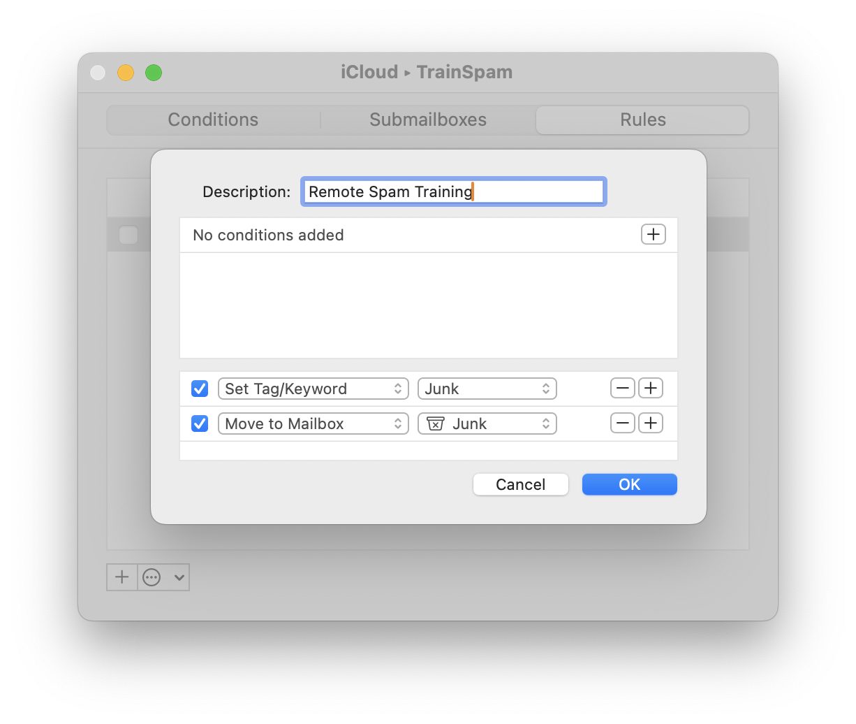

  4. For each TrainSpam mailbox, select the mailbox:
    2. Click on the Rules tab of the TrainSpam window.
    4. In the Description, enter Remote Spam Training.
    5. At the bottom of the window, create two actions:
      • Set Tag/Keyword: Junk
      • Move to Mailbox: Junk
    mailmate remote train spam

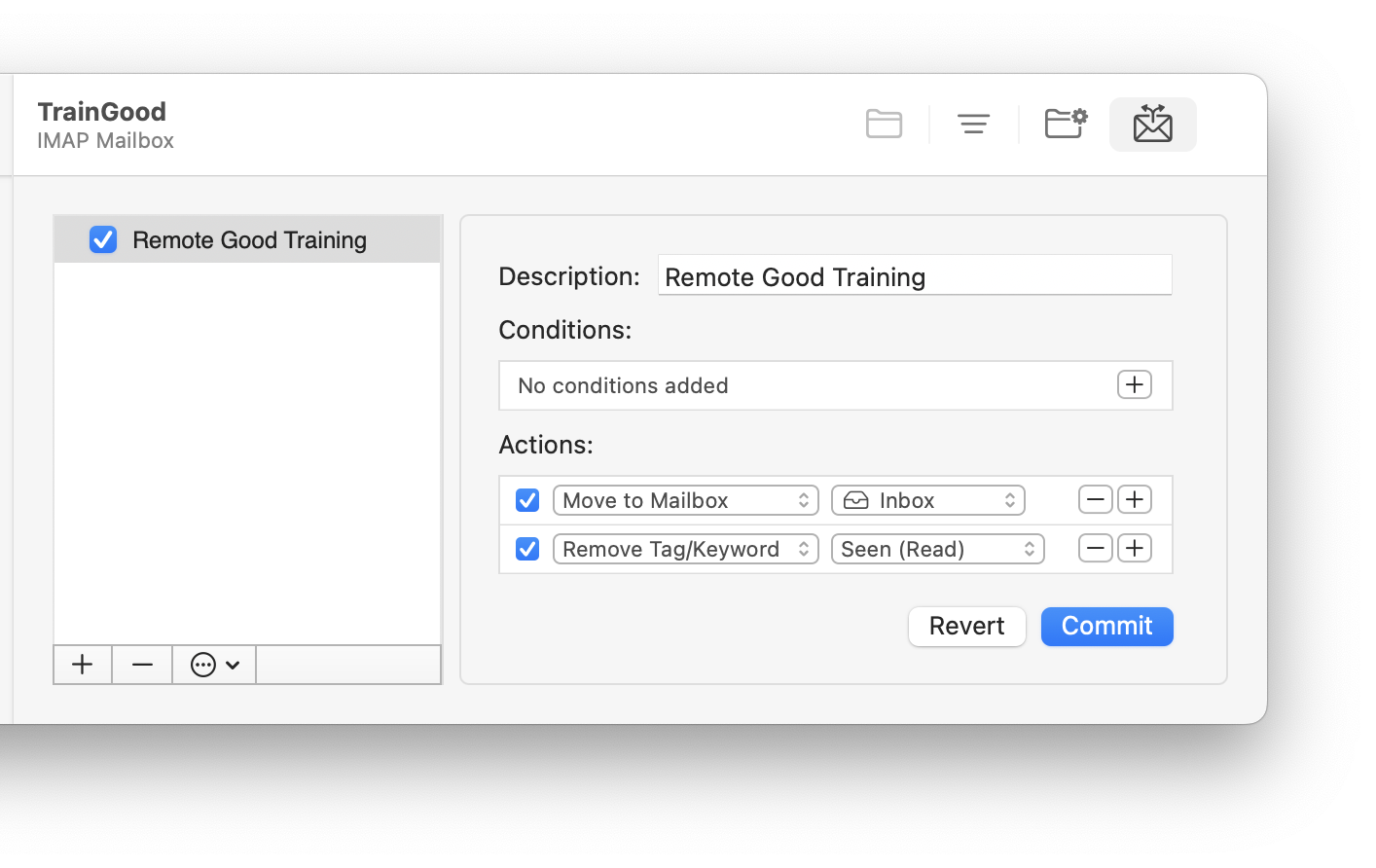

MailMate 2.x Beta
The rules interface with upcoming experimental versions of MailMate looks a bit different:
mailmate remote train good experimental
With MailMate 2.0, you should not have the Set Tag/Keyword: Not junk action for the TrainGood mailbox. (But you do want the Set Tag/Keyword: Junk action for the TrainSpam mailbox.)
